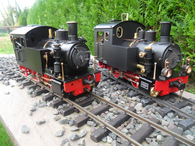

Meet my older sister!
The new one is bigger in most dimensions than my old one.

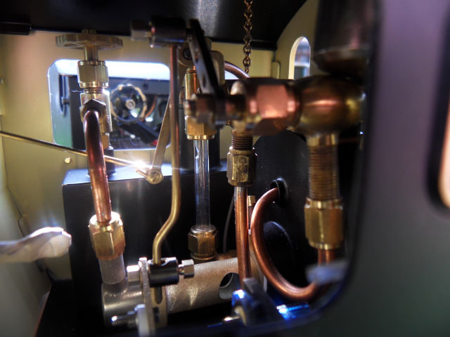

...And considerably cleaner inside!
As said already, modern miniaturised technology and building experience permits less clutter in the cab.
The cab interior was not originally this colour but blue as the exterior was.
My attempt at some creative photography... Question

Looks like quite a few detail differences in addition to the size. For example, she's grown a set of headlamps and a sand dome, but appears to be missing the air compressor on the port side.

Yes Bill there are a number of detail differences too.
The original 'Emma' was really 2 locomotives. Emma in 'G' scale representing metre gauge and 'Lena' in gauge 1 representing a standard gauge loco but both made use of the same body and chassis.... scratch
Lena was overscale and Emma underscale.
