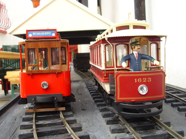

PostSubject: Re: Spanish Occre Tram build   Sun Jul 18, 2010 4:21 pm
pjti wrote:
Carl, any input re. your Madrid tram, is that to scale ?
Difficult to say Patrick without actual drawings to compare to but up against a Bachman tram it certainly looks right.
Here are some pics that you have probably seen before.
What a stupid looking figure driving the Bachman, straight out of Disney Adventureland. Clive's man is much more the part. Razz
