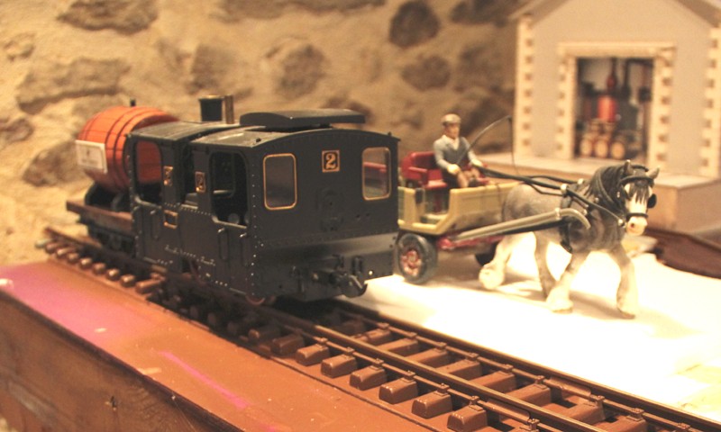

PostSubject: Re: MOMI Cognac Module   Thu Jan 12, 2012 6:46 pm
Haven't been able to do much for a couple of days but back on the project this afternoon.
Have got round to fixing the track bed 2mm card and providing drop down wires to power the track
for example these holes/wires will supply the main track...
and these to provide a switch to isolate the siding...
I'm using 2.5mm mains cable and soldering direct to the base of the rail...
the resulting wires will be easy to hide in th track ballast...
also has the advantage of being stiff enough to hold the insulating gap without an unsightly LGB insulating joiner...
I repeated the process for the rear tracks and then gave the rails an all over background spray of rust brown...
The rear tracks next to the loading dock will mostly be buried but I'd rather spray them now rather than hand paint the inner surfaces later. I think I'm now set to get on with the detailing work, roadway and foreground structures.

Paulus wrote:
Nice lookoing Stainz conversion BTW! Any more pics/info on that one?
It's just a couple of Stainz cabs glued together on a Playmo chassis...
