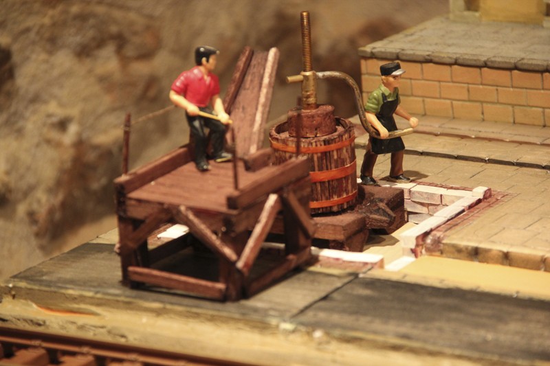

Today's efforts have been focused on building one of the key foreground objects - the grape press...
and now that the track is down starting to fill in the ground decor...

Wow! That grape press looks good. The turntable an street are suburb!
What did you use for the street pavement?

The paving is 10mm foam board with the patterns pressed in with a blunt pencil.
If you get "Continental Modeller" magazine there's been a whole series of articles by Emmanuel Nouaillier on using foam board. The February 2010 issue is on road surfaces. His articles are for HO, but it's even easier when you scale up to G.

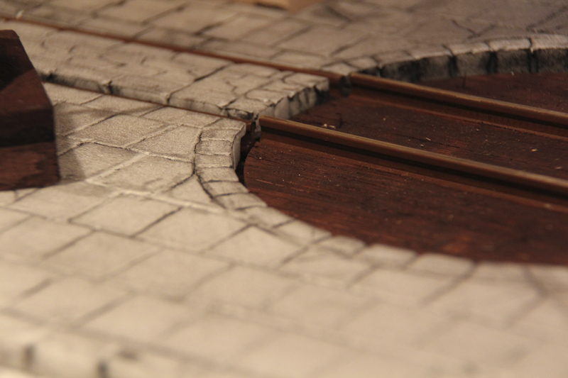

Slow progress this week with the tedious but ultimately satisfying business of hand impressing the paving and brickwork and then sponging in the paintwork. This is now largely done apart from a ramp and steps etc...

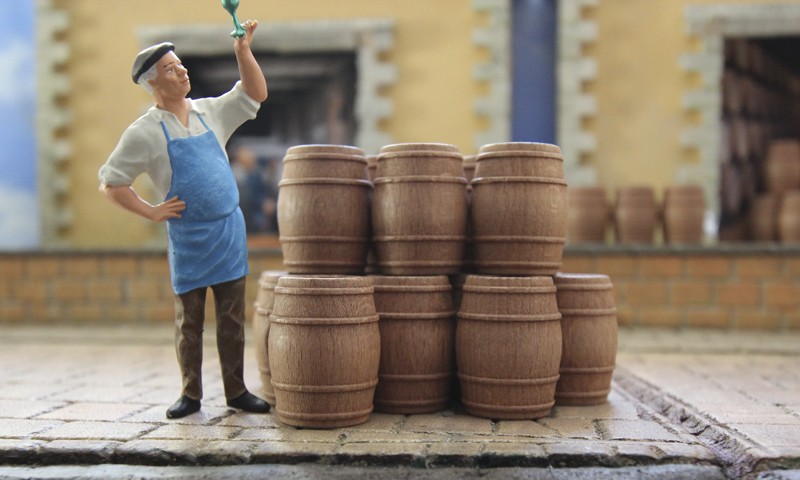

I posted this pic on the "barrels" thread as well. But here are the latest additions to the module...

The barrels look better here than on their website.
I have ordered some other varieties on e bay.
The figure looks good. I feel I've seen him before but where does he come from?
PostSubject: Re: MOMI Cognac Module   Tue Feb 07, 2012 4:25 pm
Preiser via Jeremy in South Wales

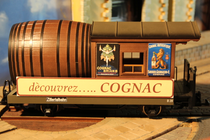

I've done a bit more on the module... completed the building roofs and put relevant signage on the restuarant/advertising wagon....
Edit... The Zillertalbahn decals will disappear before the exhibition.

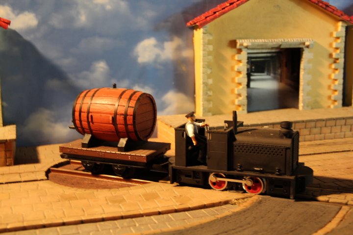

Also acquired a small diesel shunter to haul the barrel wagons and tweaked a Bachmann Driver to be a bit more French...

Splendid Brian.
Very cleverly done posters.
I really thought for a moment there was actually a marque of Cognac called Brianb and I was trying to figure out how to pronounce the word. scratch
