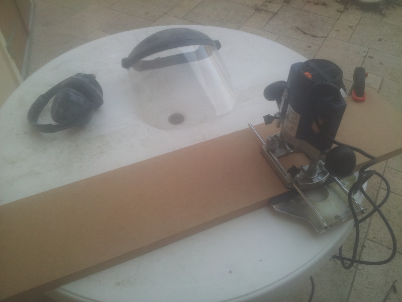

Today, this morning early I spend some time in "Leroy Merlin" tool shop in order to find some light bulb for the house, instead, I found some railling system for cuboard.
Well, I found another use of it, something I wanted to do for a while
Here how it get started :
Some of the tools
Cut the aluminium bar to the right lenght.

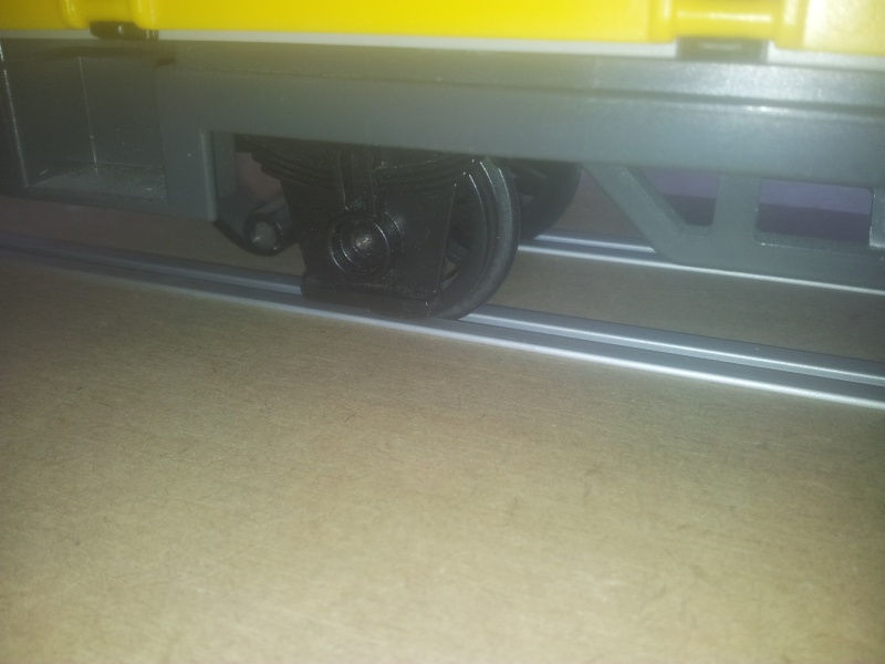

Ready to do some testing now
Looks good, tomorrow I will see for some varnished to protect the wood.
Here the wooden board is a meter long.

Ready made tramway inset track.
What are the dimensions please Laurent? The flangeway gap, depth and the 'rail' surfaces width.
Thanks.

I got it, as I had to calculate where to do the groove in the wood.
It come as a 2 meter long aluminium profil, It's for sliding system.
Cost me 9,95 €

The brand is "HETTICH".
There the one you saw and there's another one that looks like a rail with a large flat feet that could be screwed.

They cannot bend a lot, possibly cutting half on each side every few centimeter might do the trick. Not sure how it will look.
The rail I bought are made of aluminium, there's some made of plastic as well.
