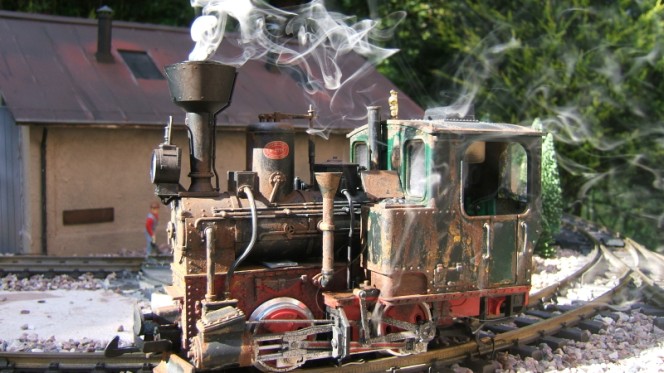

A G scale friend donated a dismantled Stainz to my railway.
After I had removed the motor and all other useful spares, I applied a commercial product to acheive this look.
With hind sight, if you use iron filings mixed with PVA (paint onto object and allow to dry) then apply vinegar to the surface, you will get the same effect at less than half the price.

Here is another pic before the tarpaulin was put over the cab and a plate put on the spark arrester to stop birds nesting.....

PostSubject: Re: Acheiving rust on rolling stock   Sat Jan 03, 2009 11:20 am
No Very realistic Paul but I just canít see myself doing anything like that to one of my locos. No
PostSubject: Re: Acheiving rust on rolling stock   Mon May 04, 2009 5:55 pm
I have since restored the rusty Stainz to full working order - not in the looks department though Laughing
PostSubject: Re: Acheiving rust on rolling stock   Thu Jul 09, 2009 11:48 pm
Wow look at all that smoke! Real or photoshopped?
