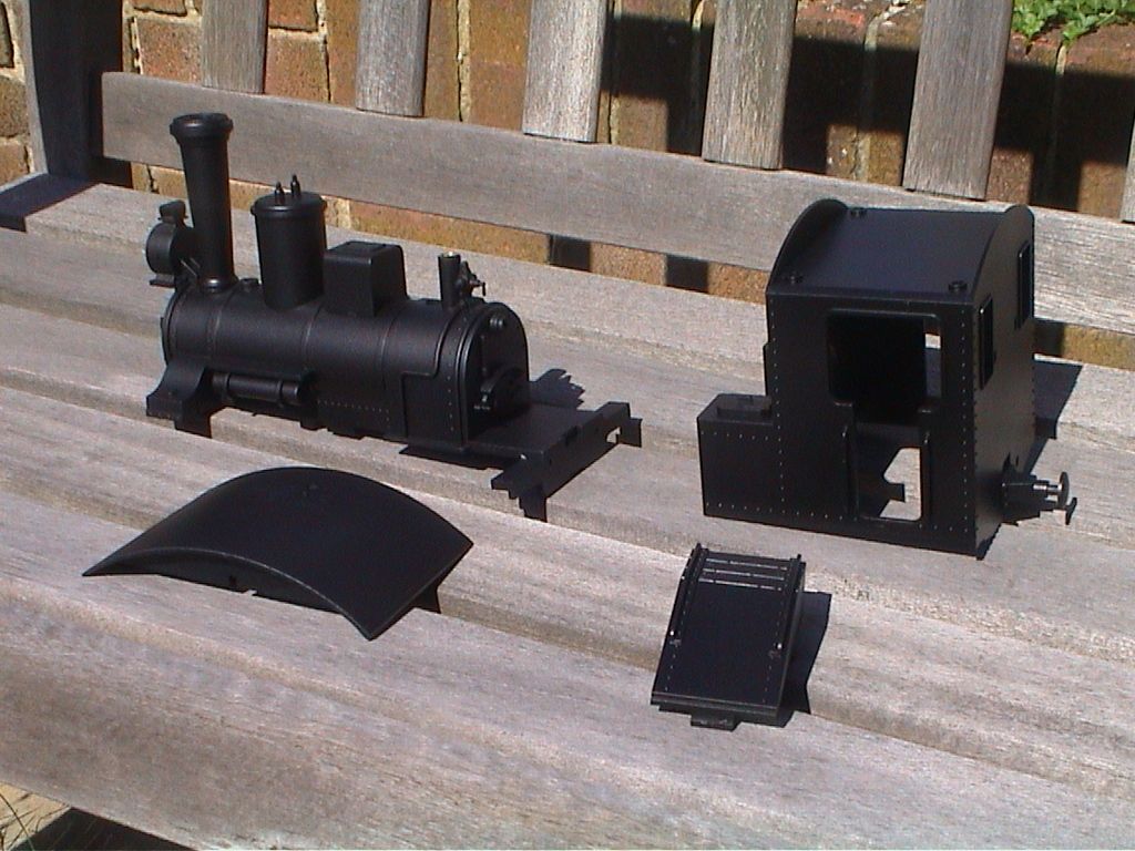

I figured that in order to weather it, I would first have to give it a decent surface to work on. As it stood, the shiny plastic was likely to resist any attempt to apply acrylic paint to it. In order to do that, it followed that I should first dismantle the loco into as many parts as practical, bearing in mind the need to ensure that it stood a reasonable chance of still running once re-assembled. Loosening a mere 6 screws was enough to yield this level of dismemberment:
I decided to keep things simple by just giving the loco an all-over black look, courtesy of a 'satin black' car-body spray primer. Before doing so, however, I trimmed off the rather oversize drip rails from the cab roof:

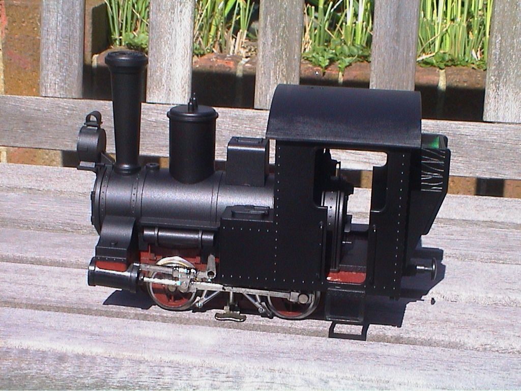

Once the paint had dried and the loco reassembled, it was already starting to look an improvement even in an 'ex works' state:

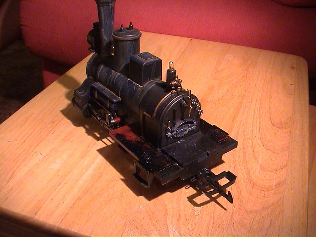

After a period of being allowed to dry overnight, it was time to have a go with some 'rust' colour, on various points:

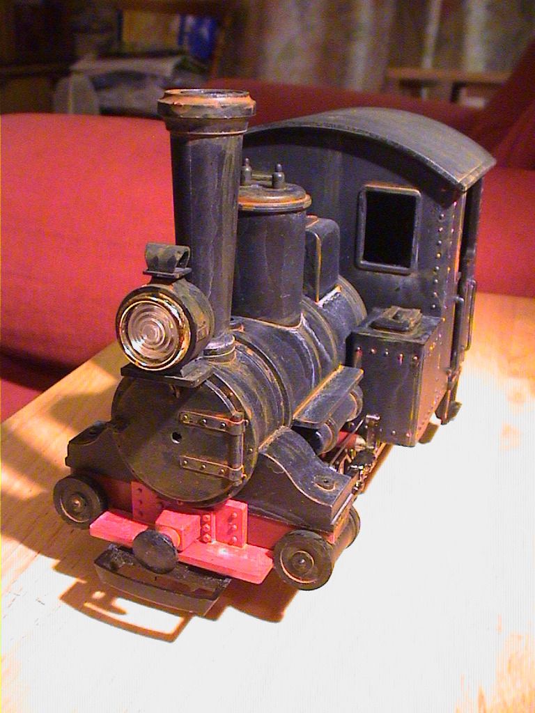

The cab had a fair amount of detail to it, so I took the opportunity to make this more visible:

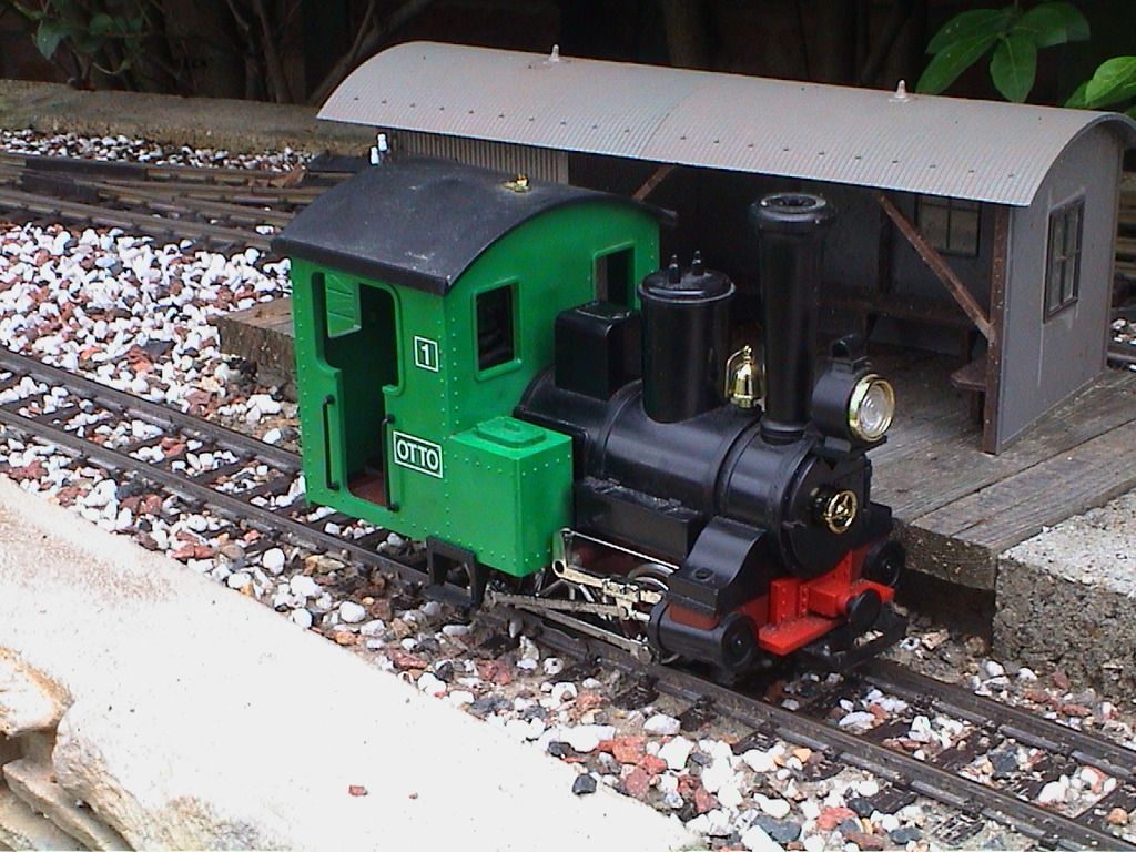

Back where it started, and looking certainly less of a toy than before:
Finally, out on goods duty with real coal in the bunker and some smoke oil in the chimney:
