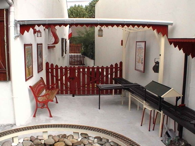

Here's my steam-up area which is off a long part double track branch from the main circuit through the shed.
There are two turnatables. One a simple 45cm and the other a 60cm crossover with track grooves routed out of MDF (yes MDF outside...) and screwed to a rotating base on small roller castors rather like a 'lazy susan'.
The two road flap folds down to allow more visitor space and the area doubles as a dining place occassionally.
Note that this is in a surburban garden and my neighbours house (bedroom) wall forms the boundary.

wow Carl. your 'steam up' area is bril! It caters for just about every combination!!
PostSubject: Re: Live steam question   Thu Mar 26, 2009 7:50 am
Carl did you route the grooves and then put rails in, or just the grooves with the engine running on the wood?

Just the grooves and the wheels run in the wood. I painted the edges with metallic paint.
I actually used a biscuit joint cutter rather than a router. It is easier to do straight lines and the 4mm blade was just right for the flangeways.
I've done loads of shelves like that too.
MDF soaked and well treated will last in a sheltered garden no problem and the wood is hard and doesn't expand and contract like ply.

I just love that set up, so tidy, I daren't let Caroline see it, she'll expect me to keep mine that way!
How did you achieve the curved section elevated track ??
That's exactly what I'm wanting to do to complete my high level circuit.

Sorry I don't have any construction photos but it is a 1.2mtr radius curve on a 1:50 ramp.
The base is concrete, cast using polystyrene as a mould and the supports are cut, treated 70mm sq fence posts screwed with brackets to the curved concrete base. The trackbed is 18 mm exterior ply.
