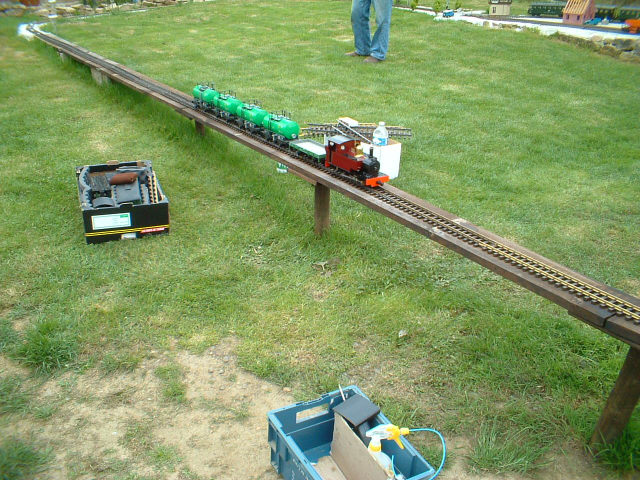

Anyway the three of us Brian,Mike and myself had a great day swopping bits of info and running trains.Mikey had problems with his loco and tender,the cable connections between the power pack(tender) and loco failing.Brian gave Mikey and I a quick demo on railing bending,also showing us his soldering technique on brass.First off Brian ran his Edrig,with its added cab and steam whistle it was a joy to watch it run round.
Had three runs with the lawley,1st run solo had a high scale speed,2nd run with 5 of Brian`s trucks and the 3rd run solo at a very slow speed,slow enough that she only just managed to climb the slight incline.She was a joy to watch,running so slow and smoothly.
We did not time the lenght of the runs but we chatted plenty so 15 minutes would not be far out.
In between all this Mikey and I were introduced to Sebastion and Belle and had a lovely lunch.
I think I can speak for Mike when saying thankyou to Brian for letting us loose on his track
and to Brian`s delightful wife Caroline for providing lunch.

Here we go
MikeyH setting up loco
I give up
Pics via email to you Carl

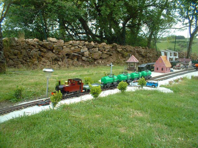

Some pics supplied by Van.
Van's Lawley hauls a rake of tankers up the incline towards "Coin de Peche"
Mike fettles one of his his battery powered loco's
You can edit this post directly yourself Van if you want to add some words to the pics.
