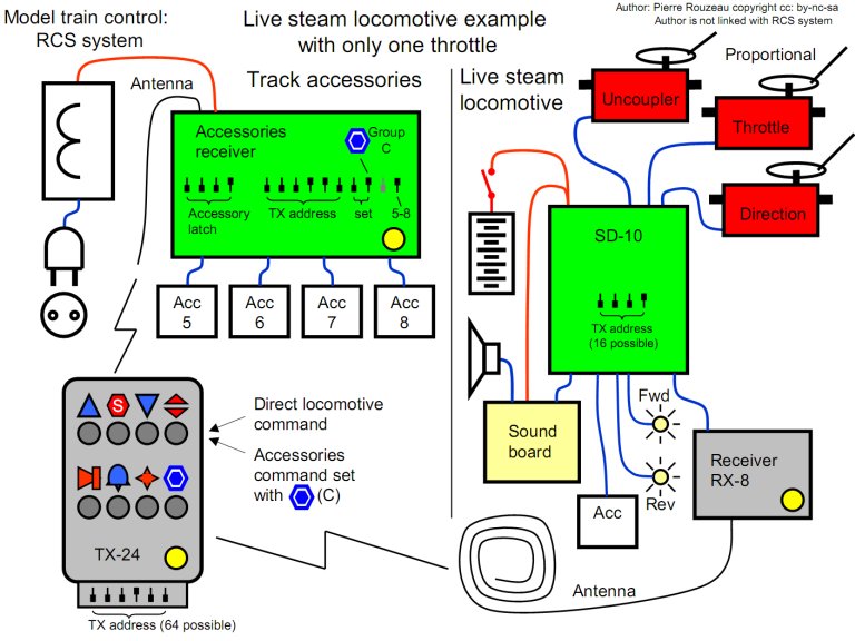

I was in search of a radio control for garden railway.
Looking the miscellaneous manufacturer websites, it seems no one is willing to define the basic specifications of their proposals.
For knowing the capabilities of the systems, it seems the only way is to analyse the gore details of the manuals.
Also, being in Europe, the number of systems complying with radio regulation is limited.
I was interested by the Australian RCS system, who is no better than his competitors in presenting its materials.
I've decided to draft a schematic to understand how it was working, which have helped me a lot.
So, here are these schematics and specifications in a more polished version than my initial draft. Enjoy!
Please note that I do not own (yet) the system, these info are only taken from RCS documents.
I am not involved in RCS business and it shall be clear that I cannot guaranty anything at all.
Yet, I am awaiting impatiently comments of RCS about theses drawings (shown here : http://rouzeau.net/Technique/GardenRailwayRCS)

I have been very impressed with the RCS system and have a few friends here in France who use this system.
They (Tony Walsham and co) are very helpful and knowledgeable about all things train control.
Your excellent illustrations are very useful to explain how it all works as the RCS information itself can be a little daunting.
Have you shown these to RCS?

I've sent the info to RCS around 10 days ago, along with other comments on his system, via the contact box on his site.
Having no answer, I've expedited at the begining of this week by same mean, with also an alternative e-mail address. I was expecting a quick answer, but as I didn't get it, I decided to publish on forum.
I especially don't know if the live steam SD-10 is available, and also what is the shipping cost to France.
I have done this work because I think the RCS sysetm is quite clever but really, it needs specification and a more general doc if he wants to sell it. Plus the distribution is limited. He have a reseller in UK, but shipping from UK is ostly and they are not in Euro zone. Probably better to ship directly from Australia. And you get some chance not paying the duties if the parcel is small.

I finally got an answer from RCS, the mail was not going through Sad
Two main comments:
1/ Track receiver current is filtered and is ok for DCC locos (that's not what is written on the docs)
2/ The live steam receiver SD-10 shall most probably be never produced again.
From mail of RCS, it have been killed by the 2.4 GHz radio, which have a much better range. He says that the power of the RCS transmitter is unsufficient to improve the range. This is most probably due to difficulties to have a good reception in the live steam metallic locos.
This is pityful because the RCS system was the only one being able to handle either live steam, battery loco or analogic track.

Hello, I got complementary infos about RCS live steam board.
The problem of the RCS live steam board SD-10 is that it was developed with an electronic circuit which is now deprecated. So continuing production needs to restudy it with new circuit like PIC. RCS considering that the market have diminished for live steam due to 2.4 GHz development have got other priorities.
