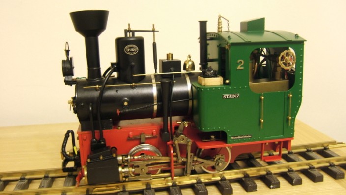

At last......Wink
Looks very clean and unblemished from the photo.
I see a working headlamp, and a shiny brass centre buffer!
If you need any advice then please ask. It is essentially the same mechanical locomotive as my Chiemseebahn.
They are rather different to run than Roundhouse and there are a few tips if you want.
Thanks Carl, Clive - my first task is to fit 2.4 GHz R/C.
I have the gear to do it, I need to sit down and study the instructions throughly.
The guy that sold me the loco was very helpful indeed and gave me a few tips.
(Like the gas lasts longer than the water so it needs filling every ten minutes or so - there is a sight glass fitted in the cab too).
He ran it with th ebatteries and the receiver in a tender.
I intend to fit the receiver and the batteries in the loco - receiver underneath and the batteries either in the cab or underneath too.
I would be interested in how your friend that owns a black version tackled those two items.
PostSubject: Re: Regner availability   Mon Nov 30, 2009 8:35 pm
I am pretty sure my friend Daniel fitted the receiver underneath the loco and the batteries were loose in the cab but sometimes he ran with them in a trailing wagon.
There wasn't enough room for batteries underneath beacause of the servo for the cylinder drain cocks.
I took my servo off for that and just operate them manually with a small stick.
Has yours got a water fill valve?
If not it would be worth getting one from Regner.
There are 2 types, ref.20230 with a bracket fitting (winkel.....) and ref. 20235 a stud fitting.
The boiler is quite small in these engines but very efficient due to the cross tubing construction and it will literally drink water.
I have to top up mine every 5-10 mins depending on load. They can quickly run out of water
as I have done a couple of times.
The servo for the valve gear needs to by quite powerful as the arm and linkage need a firm movement.
Thus the battery pack needs to by quite powerful too. I found 600Mah no good after about 15 mins use especially if you are using lights.
PostSubject: Re: Regner availability   Mon Nov 30, 2009 8:42 pm
Thanks Carl.
The filler spout is as per the real loco - see side funnel on the pic.
I can "inject" water here with a plastic syringe - I think.
The guy that built it has fitted a whistle inside the frames plus a manual lever inside the cab for the drain cocks.
So, provided the whistle outlet is pointing away from the receiver/batteries, I may be okay to fit both underneath.
I am "well chuffed" with the loco.
It oozes quality.

PostSubject: Re: Regner availability   Mon Nov 30, 2009 8:44 pm
Thanks Carl.
It oozes quality.
