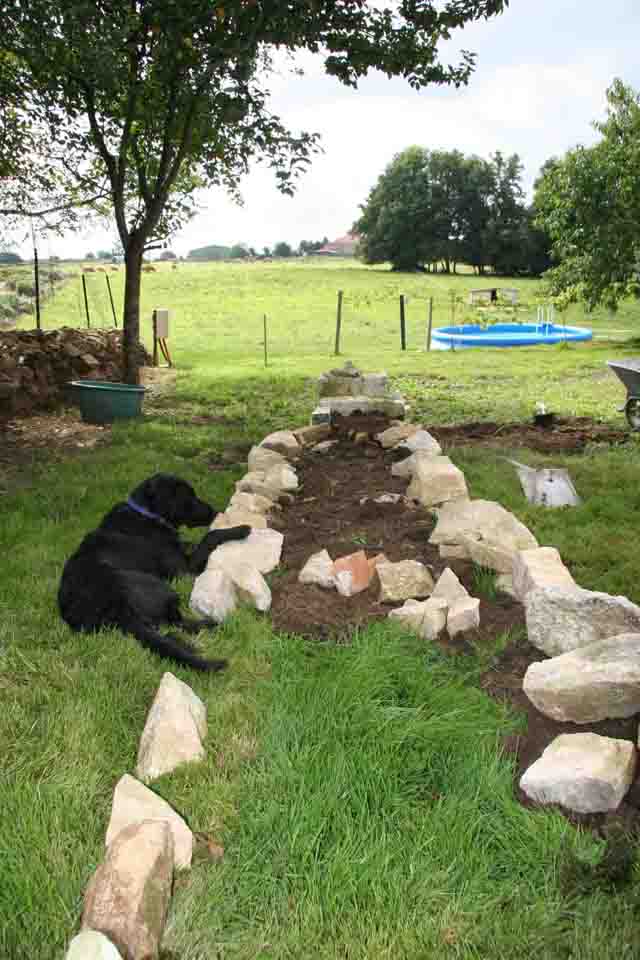

I've posted these pics before, but they show where I'd got to last Autumn...
I'm standing where the stream and bridge are going
Baguie the dog is lying on what will become the passing loop

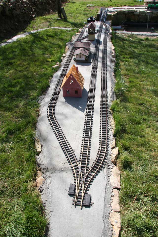

Tomorrow I'll take and post some pics to show development in the raised sidings area

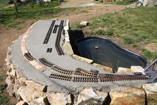

PostSubject: Re: Today on the CFHC   Tue Mar 17, 2009 12:52 pm

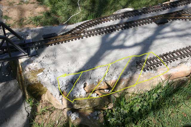

The raised sidings area ready for surface concrete ...
And afterwards ....
PostSubject: Re: Today on the CFHC   Tue Mar 17, 2009 1:48 pm
Progress at last brian! Just wondered if you had put a foundation under those stone blocks?. I did the same thing about 5 years ago by building a raised flower bed.The weight of the blocks and loads of rain caused the ground level to drop and broke up all my concrete within 6 months. If you have done a strip foundation then ignore this!!
PostSubject: Re: Today on the CFHC   Tue Mar 17, 2009 8:23 pm
Some great Empire building.
I like the different levels and the figure of eight track plan. I have that here too but much lower.
Are those sidings for 'steaming up' and maintenance or just storage or station area?
If they are for steaming up, access and bending over might be a bit difficult although the height is good.
As you are going to run regular steam I would recommend a good accessible dedicated steaming bay off the mainline where you can make a mess.

Thanks for the tips guys...
No concrete foundation, but the stones have had 5 months of wet weather to settle, so here's hoping.
The sidings area was for a few buildings and stock storage - to date I've steamed up off track - but a seperate feed area is a good idea. Perhaps the passing loop can be for steaming up in the meantime. I can only afford R1 turnouts into it, so fast counter running trains are probably off the menu for the time being.

Having concreted the "passing loop" area, I find I have enough room for three tracks and following Carl's advice a steaming up branch (marked red on the plan)
Pics of actual track in area tomorrow.
