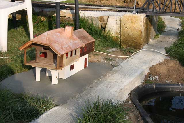

Sorry, no real stage photos but the basic construction was from old 5mm exterior ply - recycled from Football Ground Hoardings befor ethey went digital.
Glued with exterior pva, and reinforced with corner fillets.
Each roof was given a coating of epoxy resin and reiforced with glass fibre mat.
I was in a quandary with the roofs until I met Mikey, my original plan was to try and sculpt roman tiles out of car body filler - glad I didn't go that route!
The exterior cladding - artificial logs roughly split out of 10mm Balsa sheet.
Apart from glass fibre resin and mat everything else was left over materials to hand - you have quite a lot when you've spent the last two years converting a barn to live in!
The original inspiration came from Continental Modeller - a couple of articles on Chamby early last year.
Here are a few pics en route ...

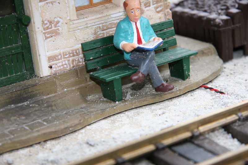

This guy has been waiting patiently for the new section ...

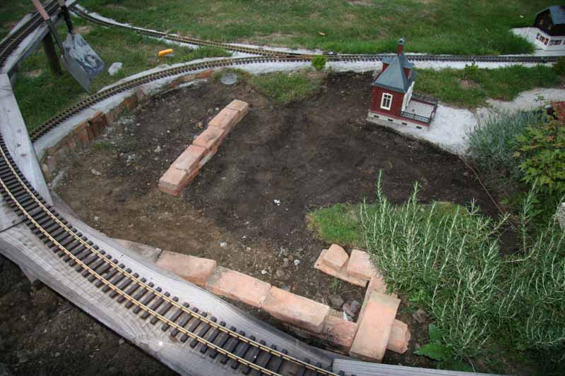

The new mayor, without consultation has granted permission for a new hamlet to be developed in the grounds of Domaine d'Etang. The diggers moved in overnight and have already cleared the wild boar hunting grounds near the lake for redevelopment.
The Count is naturally livid, particularly as he has just paid from his private purse to have the platforms extended at La Courriere for the good of the commune.
