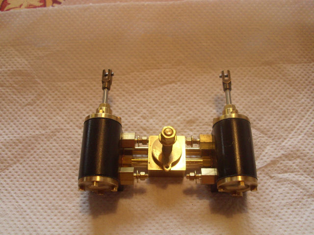

Here's a bit more progress.
Cylinder assembly after fighting with dreaded Teflon tape for the piston seals and glands.
Turret valve assembly. The two parts were face polished using Brasso.
The Regner Turret valve permits forward and reverse steam operation with a limited basic variable control. It is completely diffrent to Roundhouse and Accucraft.
Cylinder assembly complete and on with the chassis.

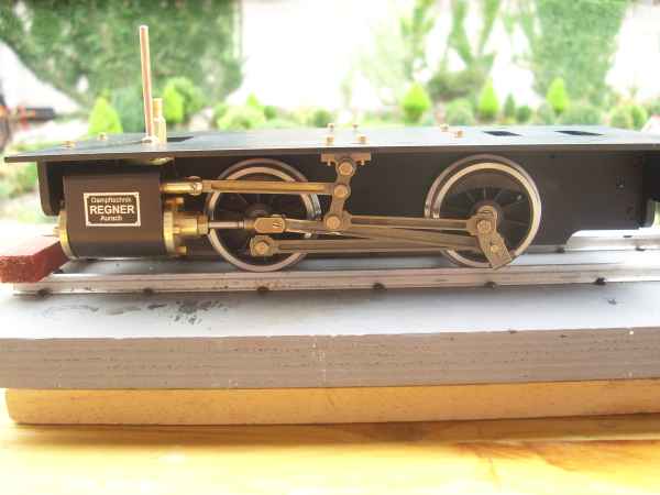

Cylinders complete and fitted. Wheels quartered which is a bit difficult with Regner (and Reppingen) engines. The wheels are secured on the axles by just a grub screw. There is no premarked position or slot hence quartering is left to eye judgement or a jig.

Complete chassis and testing under air pressure.
Many people use a compressor but I prefer a small bcycle pump as you can 'feel' any flat or tight spots in the transmission.
I had a few which needed a strip down and opening up gently of a few holes and slots.
The valve timing is reasonably easy to set up and adjust with these 'basic series' Regners.
But overall this is the most awkward part of locomotive kit building for me, getting a smooth functioning rolling chassis.
