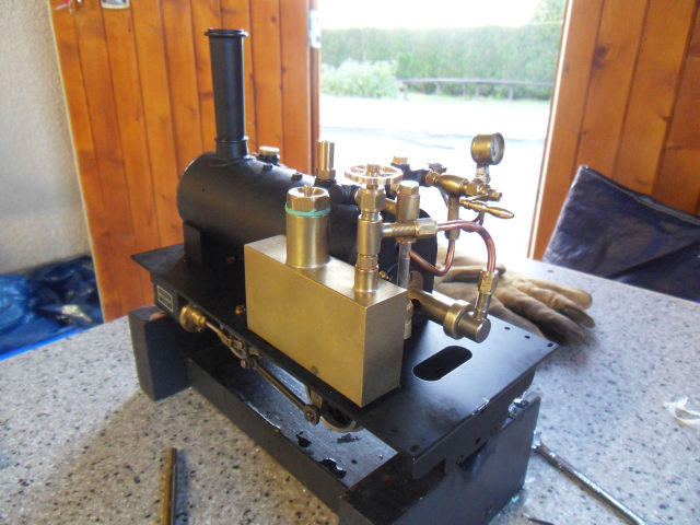

Whilst waiting for the paint to dry on another steam project I did a bit more to this Hanna.
In fact a lot more and even fired it up for the first time.
Despite several steam leaks around my plumbing and a blocked gas jet it did actually run and reasonably smoothly for a first run.

As I intend to keep this manual I needed to fabricate a reversing lever which Regner do not supply.
I didn't want to drill any more holes in the footplate so I made a bar and bracket to fit existing holes.
The link between the lever and turret valve was made with 3mm x 1.5mm brass strip.
