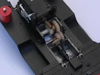

I have spent some time this summer modifying and chipping a Bachmann railtruck chassis to go under an Apocopa De Dion Body. It may be that the whole thing was just too heavy for Bachman mechanicals; it may be that I put the wrong CVs in when programing the chip (ESU XL 8150001); suggestions about what they might have been to give more torque (at the expense of lower speed) would be welcome. Anyway, I have a serious problem Sad : as the pics show, the metal worm stripped the teeth off the plastic cog with which it engages. The cog and the spindle to which it is attached look pretty firmly fixed in a cast frame. Any suggestions for remedial action would be welcome.

Hope you can find replacements as Bachman seems to have problems with spares down here in Australia. It seems a common problem with 3 people I know that have this problem in different Bachman drive units. We can contact Barrys Big Trains in America and he can help. He had gears and has a business fixing gears in Bachman eqiupment. Also we use Tamiya model cars that can have gears that are reqiured and can take a lot more work and dont strip as easy. Some also look at the gears from battery power drills and again some fishing rod reels can have correct gears inside them. Hope this helps and you are running soon. Regards from Andrew
PostSubject: Re: Bachmann Railtruck stripped gear   Fri Aug 21, 2009 10:02 pm
Hi Phil I'll bring the L'Octant catalogue on Monday, they have a huge array of gears, mail order in france!
PostSubject: Re: Bachmann Railtruck stripped gear   Sat Aug 22, 2009 7:31 am
Brian:
That's great - and you can look at the patient!
