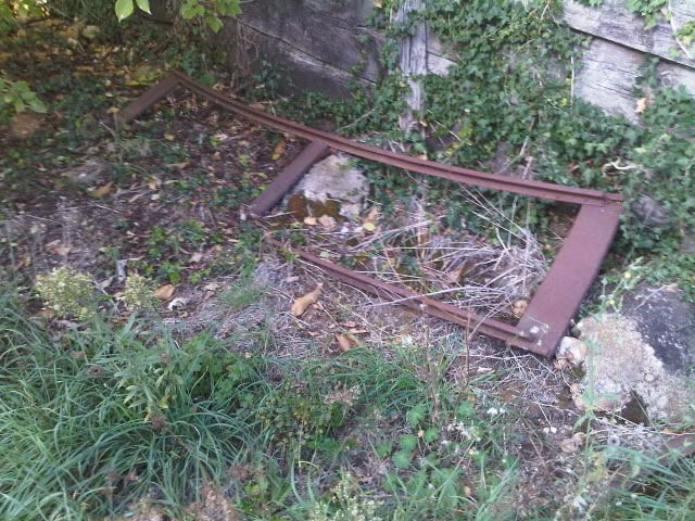

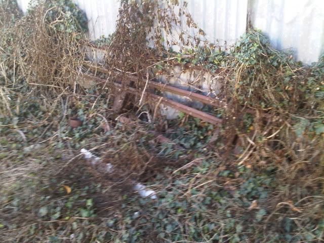

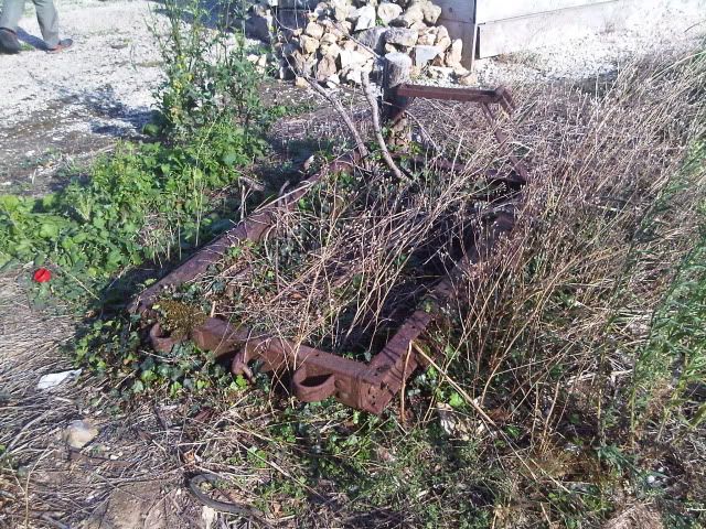

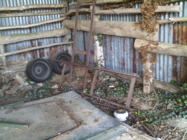

Amazing what you find on a country stroll: near the house of some friends, we wandered round a barn and found this:
and this:
and inside the open barn was this:
and even a four wheel truck thingy - been there so long that the tree has grown through it:
Our friends don't know the farmer well even though they have had their holiday home in the same village for 20 years. What is it doing in a field? Looks like WW1 vintage - could have been used for harvesting? We haven't enough land to rescue it, but I would be happy to make inquiries next year. Seems a shame to let it rust to nothing...

they look to be very light rails. Love to know their history~!!

Thanks Phil. Did you check the gauge?
It looks like 60cm but there were 50cm and 40cm lines and equipment.
PostSubject: Re: Decauville in a field   Sat Oct 24, 2009 8:07 pm
No tape measure with me but pretty sure it's 60cm. The sections were meant to be light and portable - Decauville designed them for agricultural use (and used them on his family's farm I think). In WW1, track sections could be carried by 4 men and laid at the end to move the railhead forward as the Army advanced..when it did...

PostSubject: Re: Decauville in a field   Sun Oct 25, 2009 11:40 am
Mikey: you've sent me back to look at "The 60 cm Military Railways of France" by Christian Cenac.
Quote: "The track was made with steel rails of 9.5kg per metre rivetted on steel inverse-U- shaped ties..The ties were 1094 mm long 140 mm wide and 29 mm high.. Every element of track could be easily transportable. Evey length was 5 m and comprised 8 ties. These track sections wighed 167 kg..carried by four men it was a load of 42 kg for each one...This track allowed a 3.5 tonne live weight per axle, which permitted locomotives of 14 tonnes with eight wheels or 10.5 tonnes with six wheels..."
I think the bits I found are shorter, but Decauville also produced similar track for farm and quarry use. Dr Cenac's book has track drawings that look not dissimilar to an LGB catalogue - including points and curves of varying radius!
Most 60 cm locos were suitable for use (slowly) on portable track: Decauville, Pechot, German DFB, Kerr Stuart Joffre, Hunslet, Baldwin, Alco-Cooke and petrol locos including Crochat, Simplex, Baldwin, Schneider.
Heavy loads - including whole gun barrels - were suspended across two or more four or six-wheel trucks.
A lot of ex Army portable track and locos were used on farm railways - mostly sugar beet lines - after WW1. It was used in the early days by the Chemin de Fer Froissy-Cappy-Dompierre - the finest preserved 60 cm operation - but has been replaced by heavier "proper" track on wooden sleepers - for safety reasons and because it runs far heavier and longer trains than the portable track was designed for. Derailments were common on portable track - but not really acceptable on a tourist line!
