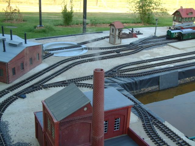

Saw it, i missed it.
Could you do some pictures from behind the factory (but not from the window too hight) to have a perspectiv of all the dock and the water. Looks impressive.
a bit like this?
PostSubject: Re: Chemin de fer Sud de Bretagne   Wed Aug 12, 2009 6:29 pm
A nice day today so put the new points in and could to alternate working out of the station round the canal.
Another trial run of the brewery smoke, is it visible?

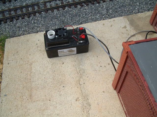

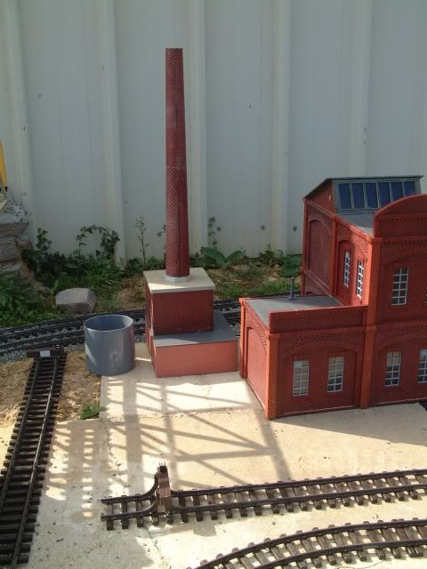

Just to amuse all you brilliant scratch builders. I had a problem, previously discussed, about whether to put my brewery chimney on top of the building or not. The reason for this was the ultrasonic smoke generator I have will not fit in the base of the chimney.
So my first attempt at scratch building a small base building for the chimney to house the smoke unit.
Basically a box covered in plastic walling sheet, purchased from Jeremy at the open weekend and a spare roof section.The stray grey pipe connector will have a top made for it to be an oil storage tank.
PostSubject: Re: Chemin de fer Sud de Bretagne   Mon Aug 17, 2009 3:57 pm
Fits in just right Peter! tell us more about that smoke generator. I've never seen one before
PostSubject: Re: Chemin de fer Sud de Bretagne   Mon Aug 17, 2009 4:09 pm
Its not a smoke generator really it is an ultrasonic fogger / mist unit, this one runs on DC and was originally intended for model boats, so has a small fan to blow the mist up the chimney. It will run for about an hour on one fill.

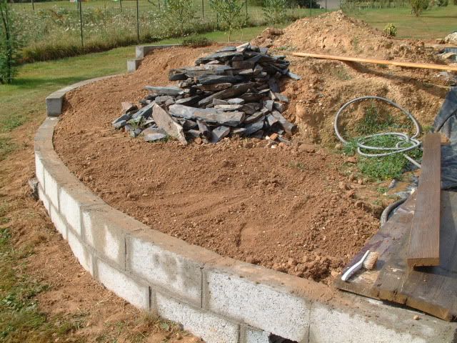

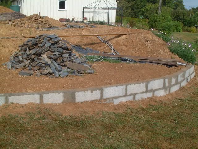

The financial management deemed that the edge of the railway needed tidying up with a small wall so that the edge of the grass could be strimmed. So obviously wall dully constructed.
It has served to confirm my levels and will enable me to progress with the outer loop, next spring. And has also proved that the bridge will only be 600mm high, so I think my Brunel viaduct is out, as there is not enough height, any suggestions for a suitable type of bridge on a curve?

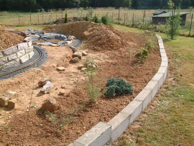

The pile of slate has been reclaimed from various parts of the garden and lends itself for the construction of a quarry, but not quite decided where yet.

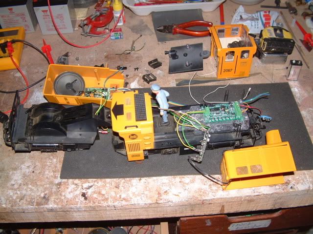

So I have been confined to putting sound units in. I got a diesel sound unit from Locosound, and am fitting it to the track cleaner. I had previously put 2 LGB decoders in one powers the cleaning wheels and the other on a different address code powers the loco itself, also doing the directional lighting and the flashing roof lights. Unfortunately the speaker I had would not fit in so I have had to put in a smaller lower quality one and I need to get a rechargeable pp9 for the standing sound.
I have also got a Massoth XLS sound decoder for my 2095.06 diesel so the only loco left now to be retro fitted with a sound unit is the Brunig rack loco and a small diesel
