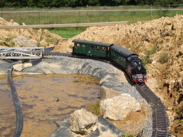

PostSubject: Re: Chemin de fer Sud de Bretagne   Fri Jun 05, 2009 5:53 pm
A minor RED letter day today the first run of a train outside for three years got the track cleaning loco running around the first completed circuit, photographs to follow when I get over the shock. bounce bounce
PostSubject: Re: Chemin de fer Sud de Bretagne   Mon Jun 15, 2009 4:08 pm
Pictures as promised. It took a while to get back into it all.
First train leaving station
It actually made it all the round without disaster

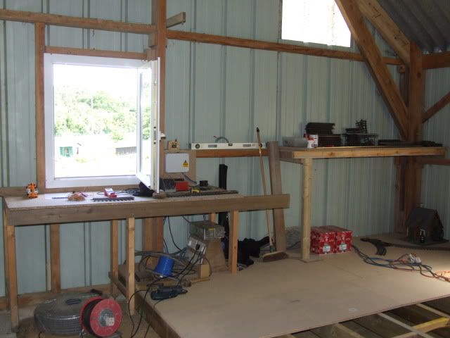

PostSubject: Re: Chemin de fer Sud de Bretagne   Mon Jun 15, 2009 4:11 pm
There has been some progress in the Train Shed. But the flooring is still to be finished. Not to mention the walls!
View from control centre window.
PostSubject: Re: Chemin de fer Sud de Bretagne   Mon Jun 15, 2009 4:13 pm
Well about bl***y time Peter!! Nice to see it though.
Hey... What a view even now. Think in a couple of years time when plants have grown and the scenery has matured a bit.

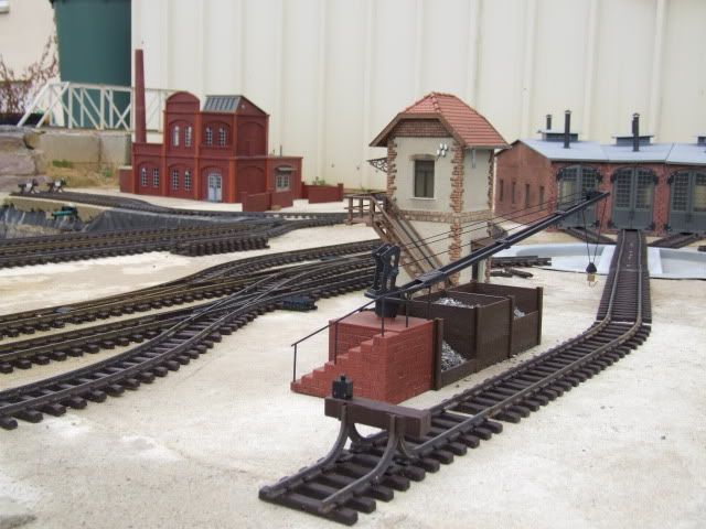

Just so that you all don’t get carried away with all this scratch built railway stuff there are a few of us that are at the other end of the modelling spectrum. The latest addition to the railway is the Brewery. Detail to be added and I need to work out how to do a cobbled yard at the front, any suggestions? And possibly get a factory gate with the road leading across the tracks to behind the engine sheds.
The coaling stage from Geoff looks good, just got to paint the ‘coal’ black

PostSubject: Re: Chemin de fer Sud de Bretagne   Wed Jul 15, 2009 12:41 pm
Nice looking building... I have used several of that type of wall panel for my own pipe-works - another of my ongoing project-ettes. I seem to remember seeing the brewery as a complete unit in a (Piko?) catalog, which actually did include some large, ornate 'ironwork' gates.
As for a cobbled yard, I haven't tried it yet but I have retained several old Brita water filter cartridges for some experiments involving the micro-beads that are contained therein. Don't know yet how effective it will be, but you might like to investigate for yourself and report back!
Pah, next you'll be telling me that you don't need to filter your water! Cool
