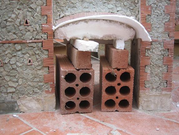

The construction method PART ONE
1 construction of the molds (porexpan)
2 positioning of the tiles
3 layer|cape of sand and putting the stones like in a puzzle
4 outflow|junket of cement
three or four days later, with the coagulated cement, he|she|it arrives the magical moment of removing the pieces from the mold
Friendly,
Amadeu
PostSubject: Re: Ferrocarrils de la Terrassa   Mon Jul 26, 2010 2:06 pm
BRILEANT!! thanks for the pictures I assume the moulds are made from (porexpan)
Polystyrene? Where do you get your ‘Tiles’ from or what are they? bounce bounce
Olot
Location : La Garriga-Catalonia
PostSubject: Re: Ferrocarrils de la Terrassa   Mon Jul 26, 2010 2:10 pm
She is polystyrene, exactly.
The tiles are bought in commercial establishments. They are constructed in pottery, clay.
The construction method PART TWO
Construction of the basis
Assembly of the pieces
Filled in with cement
the arches
in detail
preparing everything to fill in with cement
proceeding
And here we have the almost finished work
Friendly,
Amadeu
