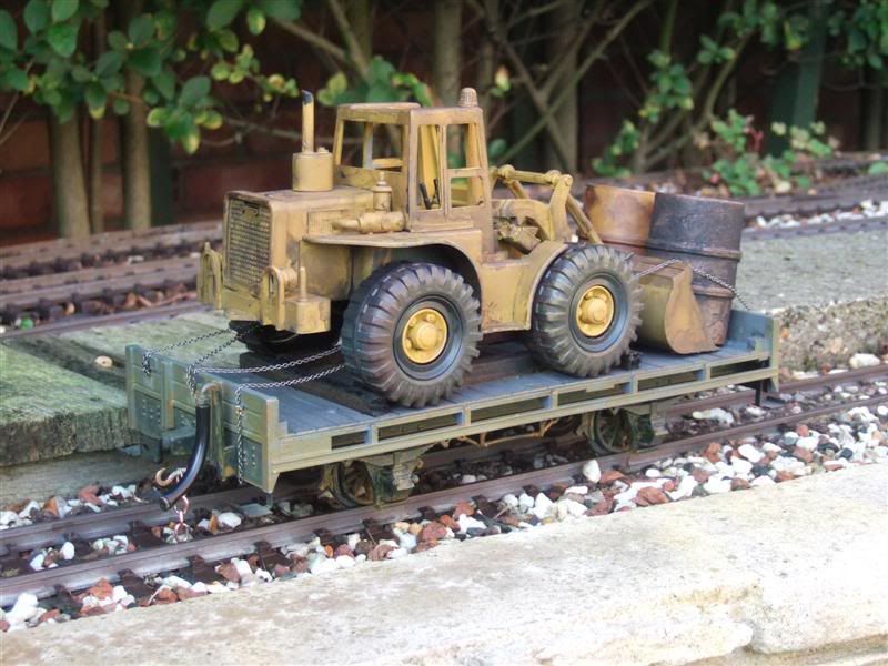

Well rather like the poor old overworked postie, I have been 'pushing the envelope' (see what I did there?) in modelling terms at least. Some may recall my adventures with making a slightly less toy-like flat-bed and digger load (a la LGB starter set).

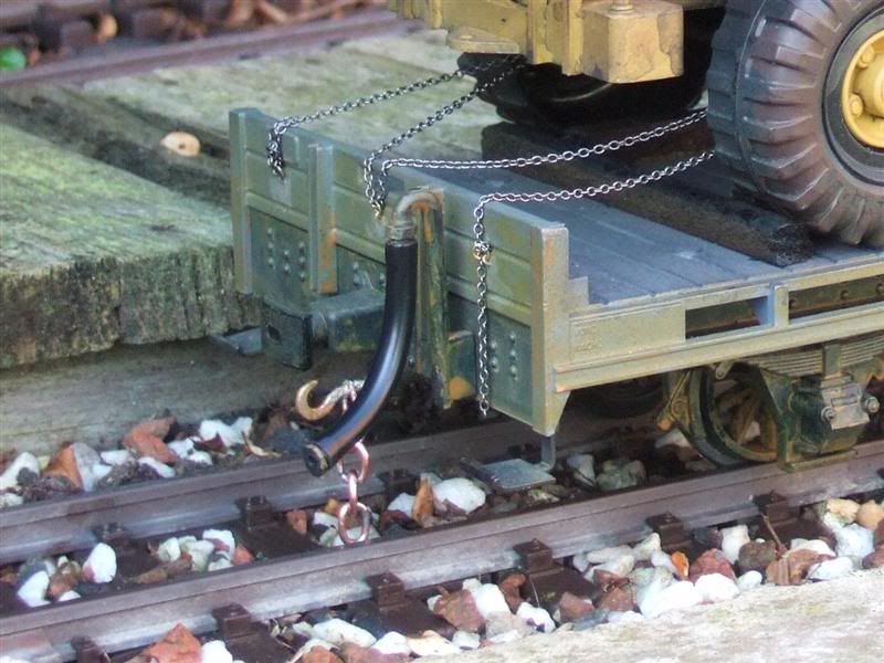

With my recent experiments with using the brass hooks/chains on the box vans, I decided last night to take one off and apply it to the aforementioned flat. In doing so, it occurred to me that perhaps something remotely interestng could be done with the moulded brake pipe? I had some thin-ish rubber tubing courtesy of a garden irrigation kit which has been 'maturing nicely' in the shed for several months now, so I had a go with a piece of that.
I cut off part of the moulded pipe - leaving a stub behind so as to mount the new piece of rubber. At the other end I cut the fitting off at the stanchion and stuck the 'nut' bit of that into the other end of the tube. Here's the result:
Here's a better shot in close-up:
The tube looks a bit new, and possibly a bit on the thick side, but other than that I think it looks the part.
Comments welcome!
PostSubject: Re: Brake pipe mod?   Sat Oct 11, 2008 10:29 am
Looks fine to me Clive, and with a bit of weathering...
PostSubject: Re: Brake pipe mod?   Sat Oct 11, 2008 5:49 pm
What about winding some wire round it to make it look like....wire wound pipe.
I made some once like that and used the very thin strands out of multi core low voltage cable.
I glued one end with a dab of superglue and wound it round quite tightly.
PostSubject: Re: Brake pipe mod?   Wed Nov 12, 2008 12:30 pm
How about using a suitable sized coiled spring (similar diameter to a biro spring but a bit longer).... use a piece of thick copper wire down the middle (doesn't have to be a tight fit) to pose the spring and to help attach to the wagon stand pipe .... then get some heat shrink tubing to cover the spring and heat with a hair dryer or heat gun until the tubing shrinks and gives a ribbed appearance.
