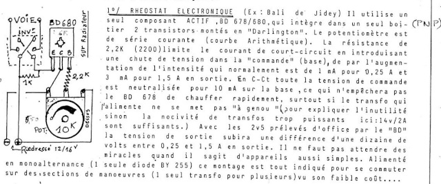

A transistor, pot, fixed resistor and a switch.
I have a simple circuit and can make one for less than a couple of euros if you want.

Yes please Carl. I've experimented with the vibrator (the electrics of course) but couldnt get it to work. I've got various batteries from 7.2 to 14v but they all make the train go just too fast/ I can repair guitar amps no prob, but trains? I looked on the net for a circuit but its double dutch to me!

tout est ici !!!! the text or the page Web URL all is here !!!!!!
http://www.ptitrain.com/electronique/meccano/pages2002/alim025.htm

That's a good circuit using one of the many voltage regulator chips that are widely available.
This was the article we did before (about the vibrator too....)
speed controller
The transistor circuit is there too. I will make one up Mikey and bring it to Chatellerault.

réostat électronique ( faible puissance ) ,electronic réostat (weak power)
