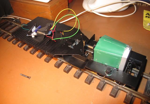

which has everything you need to trouble shoot. The Railtruck comes with a fairly massive circuit board (bigger than most decoders) which seems to do nothing but control the LED lights. It also comes with a superficially helpful wiring diagram for how to add a decoder in to the circuit board, which I followed very carefully and which didn't work. I wasn't going to have LED lights anyway, so out came the circuit board and in came a decoder (Massoth XL) directly wired.
The chassis then looks like this:

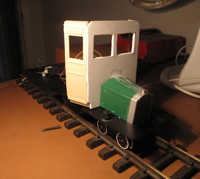

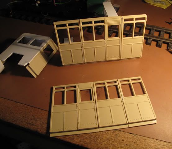

I made the cab font out of plastic card and the sides from the kit:
The first fit of the cab front on the chassis looked too high in comparison with the bonnet (the original, but shifted forwards a bit):

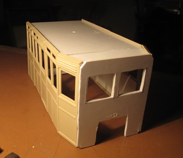

so I cut it down a bit, and took the tumble-homes off the sides to match, so the body looked like this:
and on first fit, it looked quite good - I also hacksawed off two metal bumps from the chassis on either side of the bonnet and the front of the chassis so that it ends just above the front wheels - see the prototype. Given that the two originals pictured above had different body styles, I'm happy that mine is believable. Railcars got bodied by local bus body-builders, so anything goes. Most JAs I've seen pics of had very square bodies.

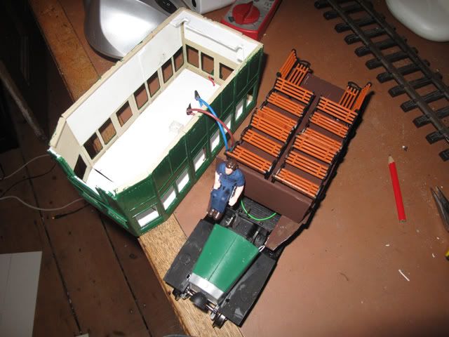

So, as said - first remove all electrics and wire in chip:
The blue and brown wires are for the interior and rear lights which are on the body. All the lights are wired into the "front light" terminals of the chip - this is a unidirectional vehicle!

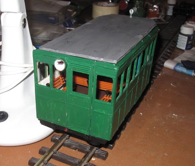

False floor to conceal chip and install seats - the cheap Chinese garden benches which are constantly on ebay:
The driver is the original railtruck driver painted with matt acrylic as "bleu de travail".
So this is how it looks now:
And at the rear, one body section from the coach kit plus an extra window section is the right width, and not too far off the "closed back" SNCV version in your pic, and Davies has a pic of an original four wheeler with very square body.

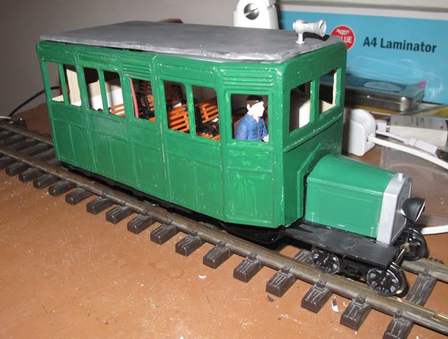

The roof is not yet fixed in place: the lights need more work (lenses!). Lights are from Regner - a Carl tip - bulbs are from a supply of 12v grain of wheat bulbs I bought years ago. The horn is from a model boat supplier. It needs another coat of paint - acrylic glosss (which I buy from Intermarche and which I was rather pleased to see is almost exactly the same shade as the original Railtrack bonnet). I have some door and grab handles (eBay again) which I will fit.

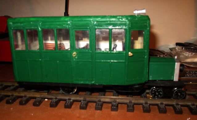

I've just noticed that the last entry from me was in December, but it's finished at last - handles (eBay), glazed, roof fixed, horn (model boat supplier). The front three-quarter view is the better colour guide - the side view is done with flash. Available for weddings, summer visits, etc!
I think a roof rack might be a bit fragile unless it was brass - and I'm not really up to that; the prototypes seemed to manage without. Lettering - a summer job for quite a bit of my rolling stock...
