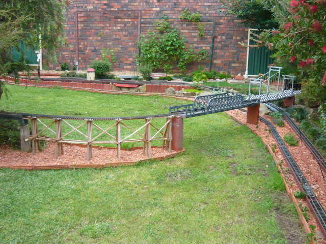

PostSubject: Re: RC/battery for LGB Stainz. Some advice anyone?    Mon Feb 27, 2012 2:37 am
Some pictures of my railway.
I call it the 'Lizard & Bottlebrush' (L&B) after the trees and wildlife that are around it.
I have quite a community of small to medium size skinks and blue tongue lizards (a type of large skink with a distinctive blue tongue that is native to Australia) occupying all the nooks and crannies around the track.

PostSubject: Re: RC/battery for LGB Stainz. Some advice anyone?    Mon Feb 27, 2012 9:42 am
Beatiful garden railway and very interesting rolling stock.
Some great looking bridges!!
PostSubject: Re: RC/battery for LGB Stainz. Some advice anyone?    Mon Feb 27, 2012 10:34 am
The layout looks great and I can see there are some interesting gradients. Do you have a track plan and how big is the garden?
Not so sure about the lizards though and maybe you have other Australian 'wildlife'.... Shocked

PostSubject: Re: RC/battery for LGB Stainz. Some advice anyone?    Tue Feb 28, 2012 11:05 am
The
suspension bridge is made from marine plywood with recycled plastic bread crate
sides, the lift out bridge( the grey one) is made from an old bunk bed side
rail with an old dogs bed sides welded to it (Thanks Andrew) and bread crate
lattice (the piers are Hebel), The trestle is made from hardwood garden/tomato
stakes.
The cane bins are made from 3.5" floppy disc mesh holders from a $2 store
mounted onto wooden flat cars, which are a kit from Pasidump in Sri Lanka via
EBay, the "pipe" frame is actually chicken kebab skewers but bamboo
skewers would do the same job.
I copied the prototype bins from memory of my youth when I worked on a cane
farm; the bins transported the cane to the sugar mill which was the major
industry of the town, side rod diesels and small steamers (depending on
vintage) pulling cane bins down the main street was commonplace in Aust sugar
towns.
In
fact one town had the Queensland Rail (3'6" gauge)main line running down
the main street.
The log car is scratch built with the logs from a dead tree in the garden.
The edging is terracotta roof tile with the back fill being crushed roof tile
the rail is laid on old house bricks with modified tent pegs spaced about
500-800mm apart through holes in the sleepers holding it down.
