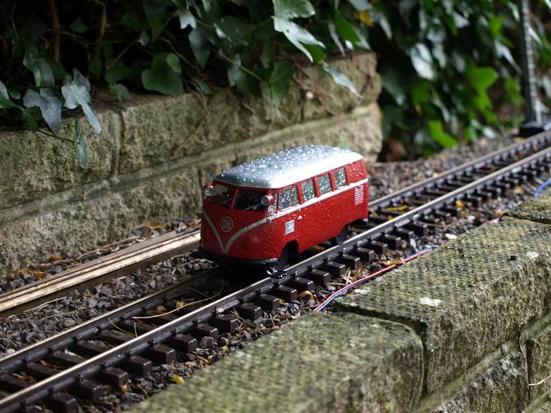

Last night (after days of sleep and fever I finally felt good and awake... at two o' clock in the night...) I builded in the Simple Critter Control and 2 switches (recycled ones) one for forward/backward and one for on/off (actually, when it's in the 'off' position it's wired to a 2,5 mm jack at the underside so I can recharge the the battery).
The electronics for the LED lights are also connected to the Critter Control. The LED's begin to shine at a very low voltage already, even if the car itself is not running. This way it can stand still with it's lights on.
An other option could be to connect the electronics directly to the battery. That way the LED's are feed constantly and therefore shine constantly (also during changing of direction).
Here it is before the wiring.
And this is how it looks like outside (don't worry, the switches and knob will be camouflaged!).
And frontview (have to do something with those blue/ cold white LED's)

Back to this long forgotten thread! Just before the RailExpo I picked this project up and made the roof rack using brass wire and plastic strips:
The switches were camouflaged and look like stuff inside a crate on the rack. The crate can be closed. The knob that regulates the speed has become a small yellow oilcan.
Here some pictures of the end result on Carl's layout during the show:
